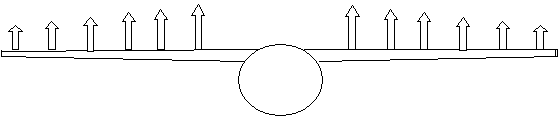

Load Distribution

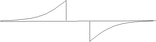

Shear
Moment
On the top is the distributed load on the wing. Nothing is to scale. The middle diagram is the shear diagram. The shear is the maximum at the root, and is equal to the total vertical load coming from the wing. Because there is an equal load being reacted at the fuselage, those 2 loads balance (wing load up = reaction down at the fuselage). Therefore, we see that there is no new shear being introduced between these two attach points so the shear in the middle is zero (implication is that you don’t need much of a shear web (so you can tie just the upper and lower caps together).
The lower diagram is the Moment diagram. It’s is also maximum at the wing root, but note it doesn’t drop, but is constant between the fuselage attach points.
